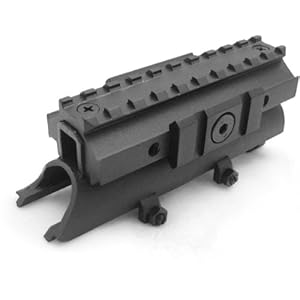

That's the one version receiver cover/scope mount there is another version which has 4 "legs" going down the side to straddle the receiver with set screws and jam nuts on each. Those do not move. But you have to be careful not to over tighten or you put too much pressure on the rails and bind the bolt carrier.
like these:
But any of them will change poi if removed to clean rifle. Suggestion would be not to remove just open action.
I have the second version similar to those in the pics on a Norinco SKS.
